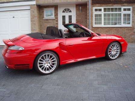

Sorry, beaten ya to it!! I have 19's on mine... no major issues except if driving hard into a dip i get a slight rub on the rears...
They fill that gap soooo much better though...

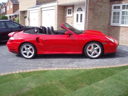

They do look good though! Here's a before photo...
