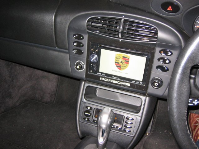

You mean a bit like mine:

It should be a relatively straightforward installation then. The speaker plugs should go straight in to the AVIC connector. You will need to connect the speed signal wire (grey/pink) from the power plug to the speed signal input on the AVIC. Also check that the dash illumination wire (grey/blue) and the antenna feed wire (white) are connected correctly. I didn't connect the reverse or handbrake wires, as I found a small wiring modification to get around the handbrake signal. On the standard installation you cannot watch videos on the move (not that I wanted to do that) or change the navigation destination and settings (which I did want). If you drop me an email, I'll attach the instructions to a reply.
I bought the trim surround from a place on eBay in the US: http://myworld.ebay.co.uk/euromotorspeed/. It was a bit pricy, but it is a nice fit.

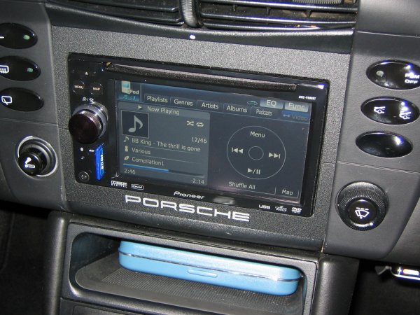

fitted today - and it took a lot longer than I thought, but all in and worked perfectly 1st time, all the trim back albeit in different places now, but worked excellently, the DVD / Hand-brake hacks worked fine as well
