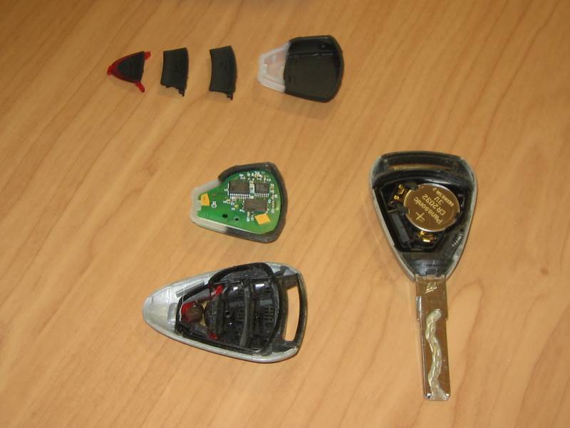

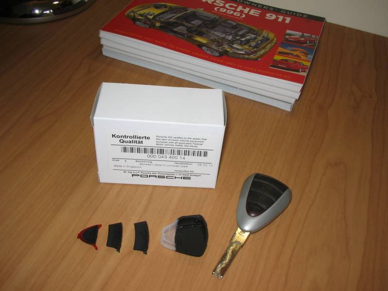

Well, this is what £34.53 inc VAT gets you:
Hey, what's that in the background? [
] - an extra £16.95's worth - much better value! The top just unclips from the pointy end, and the transmitter lifts out in it's rubber membrane:
The buttons lift out, and the new ones slide in. Replace the membrane with the new one supplied - all in all a 5 minute job. It all fits together much better than a 996 key, that's for sure! The original buttons:

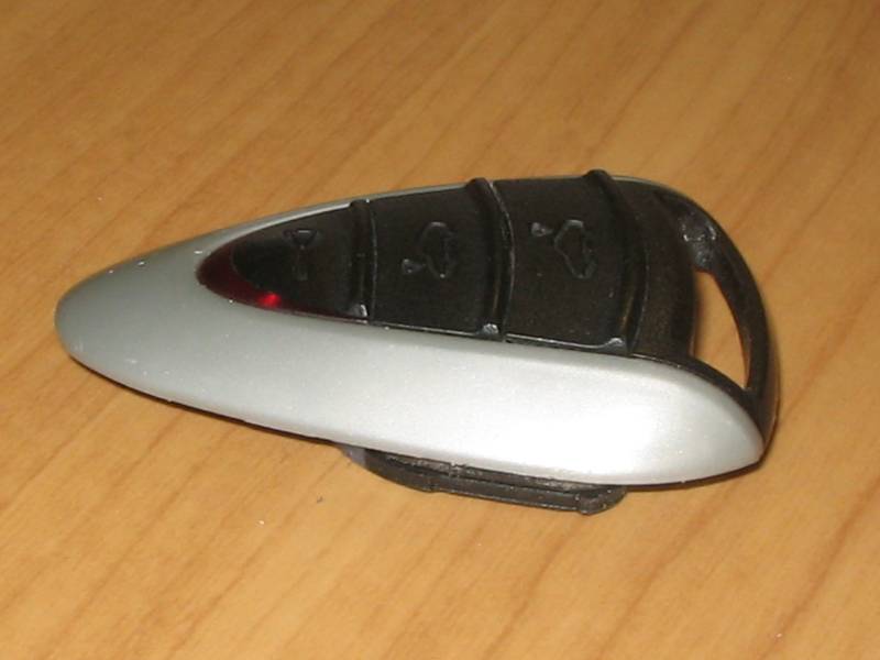

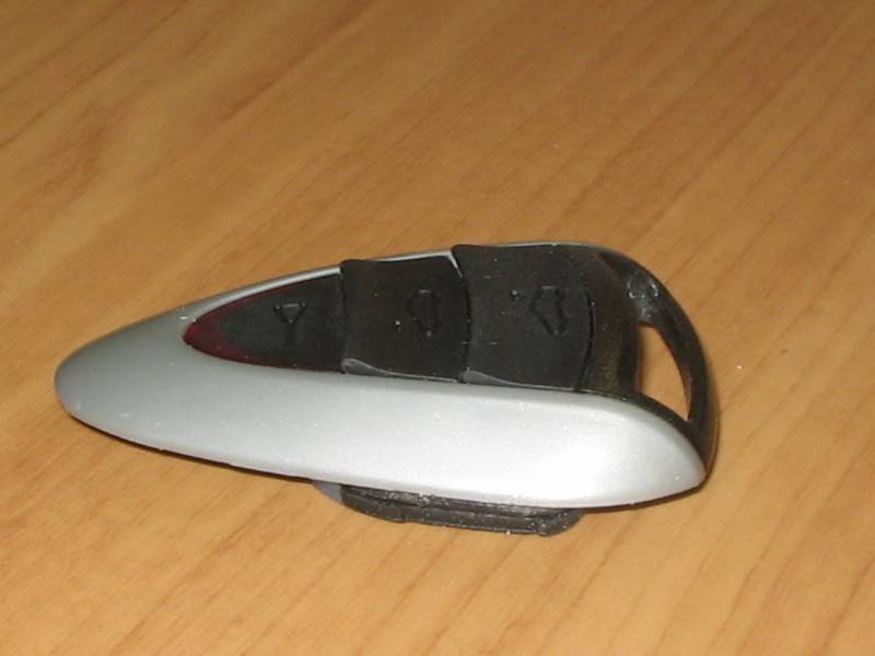

And the new flatter buttons:
As has been said, the lock button is much flatter, and the lid buttons have to be pressed on the recessed part. The new raised bars help protect them being activated by mistake. Gram for gram it is without doubt the most expensive Porsche plastic I have ever bought, but hopefully it will end my frustration!
