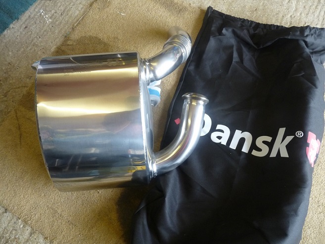

Well they've finally arrived. A dent on the reverse of each silencer, which I think is down to poor packaging. But your're not going to see them!!
But they look good, and they even came with a polishing cloth!! Just need to find the time to fit them.

Finally replaced the silencers with Dansk Sports exhaust. I know it's only three bolts to get them off and then swap the mounts over. But my car has been used in the UK as a daily driver, which means the bolts go rusty. So one stud snapped, and the M8 x 140mm bolt snapped. Soon fixed and replaced.
And the result....
Bloody fantastic!! Sounds brilliant without being headache inducing. And at a steady 80mph, no noise inside the cabin, which means long journeys will be spot on. I must stop driving with window down when leaving the village though!
The one thing that has really surprised me, is how much quicker the car feels. I can only assume the old silencers were so bad they restricted flow and thus reduced power.

I bought my exhausts from design 911. Exhaust Muffler / Silencer Sports DesignTek for Porsche 996 Carrera - which is the Dansk Exhaust. The price was right, quality looks good, and after fitting sounds just right. It's got a proper 911 growl now, but isn't about to ruin my hearing after an hours drive. But it is probably closer to the standard exhaust volume and sound than most would be happy about, but it was exactly what I was after.
The car does feel more responsive, but I guess that could be psychosomatic.
