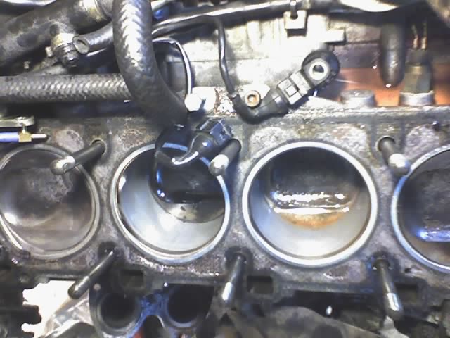

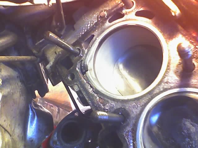

Well the head is off and it doesn't look to bad to me - I will get a second opinion though. Looks like a 3.2 monster will have to wait till I break it properly [;)]

Those phone camera pics are pretty good quality (for a phone).
Interesting that you think you may have had a widefire head gasket already. Any chance of a close up of the failed gasket ring. I bet your heart sunk a little when you spotted the light score [:eek:]
