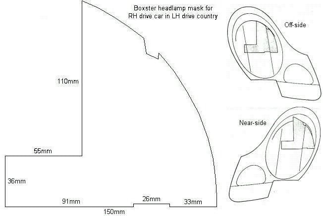

Does anyone know or have a template to change the lights for driving in France etc?

here.
Im going to try and replicate similar with duck tape for this years LeMans trip.
It is just like putting tape on a lens - just mask out 12'o'clock to 3'o'clock.
Elliots pic shows which bit to mask - better than spending 20 odd quid.
