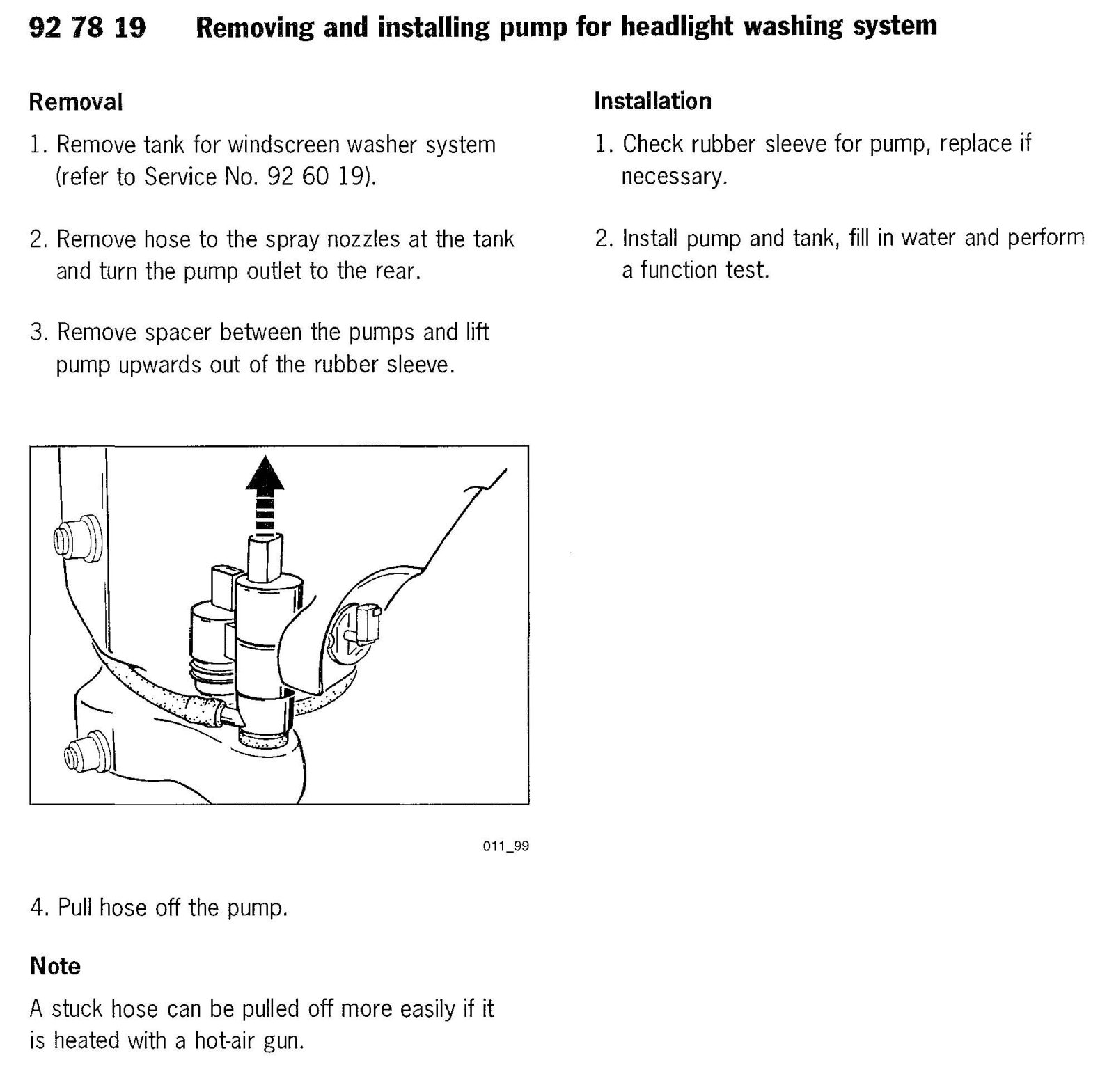

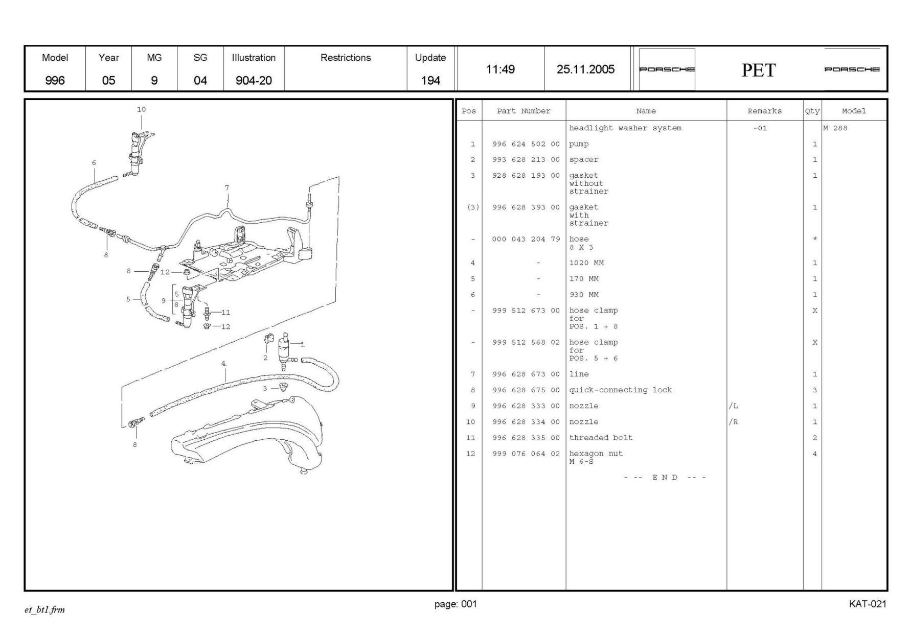

Appears I have a faulty pump...pressure is good enough to allow the washer jet cover to open up, but no more...Any DIY help for changing this out, and part number please?
