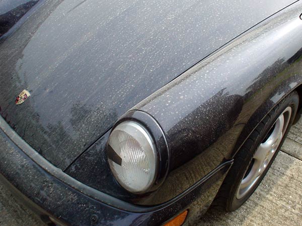

On my old 964 the glass lens actually had a shaped peice that the beam deflector fitted over, the next year i used black duct tape over this area, much cheaper and ive enough left for the next 53 lemans runs or possibly more [;)]
Look at your lens closely, on the offside lens there might be a wedge shaped deflector inside at about 9oclock, this is what im referring to.
Difficult to explain on type [:D]
See attached, this was the same shape as the bought from halfords type but didnt cost £7

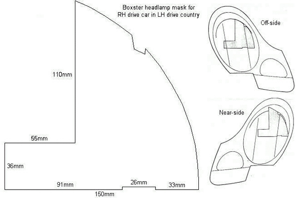

So then............... What do the Boxster owners do when driving in Europe coz this looks a bit awkward to cut out
I will be needing some myself and cant imagine sticky tape being to user friendly in this shape

Elliot,
Most Boxster owners use tape - you should be able to approximate that template fairly easily?
(But I thought you had litronics? If so you don't need the tape, you just switch it from LH to RH dip. Instructions are in the manual and in the Boxster FAQ)
