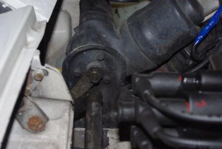

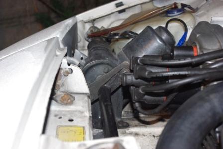

Pic here - lights down
Hope this helps

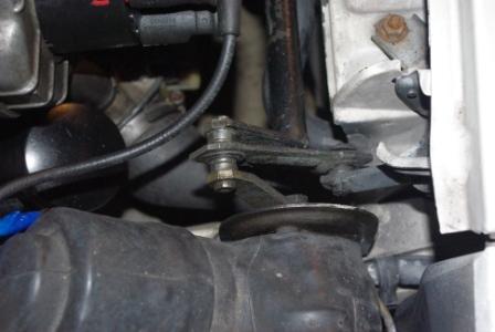

Will upload a pic of the up in a mo
Mike
much appreciated. could do with a picture looking straight down at the two arms/brackets on the headlights that i think touch the rod that the motor turns in both up and down position.
thanks again, its a great help.
steve
