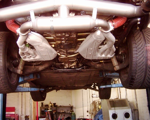

I recently fitted secondhand early heat exchangers from a breakers for £180.00 the pair. I had to cut off an extra mini cold start heat exchanger bead blast and HT paint them about £35.00 all in. I bought a Triad 2 in 2 out exhaust for £233.00 inc shipping and the oil pipes came from Bert gear for about £120.00. Stainless exhaust tips were £40.00 a pair from Porsch-Apart. I had no problems with broken head studs and the like and there is a noticeab;e performance gain. My car doesn't see rain very often so expensive stainless items are a waste of money to me. If you go for an early free flowing exhaust system instead of the restrictive nonesense fitted to the stock car and you want stainless buy SSI, Dansk are not worth the little money you save over SSI and contain mild steel components. If you are keeping the stock set up, it's potentially a mine field and the only way to get through it is to do plenty of research, call JZ, Autofarm and other independents for recommendations, ask what they fit, then ring around the suppliers and ask the brand name of what they are selling.

Thanks for the comments and ideas. My car already had a stainless main silencer and I have fitted a stainless pre-silencer from Malton Specialist Cars which is a well made piece of kit at a good price. I have got a new stainless cross over pipe from E-bay another good deal. SSI exchangers would be very nice but time you change the oil pipes as well you are looking at a big bill. I will phone around suppliers and breakers and see what is available unless anyone has any other ideas.

Heat exchangers are done I managed to get a pretty good second hand pair from Discount 9 Auto £191 including Vat and delivery. What a pain of a job to fit though and I was doing it over a pit. Dont even think about it unless you can get right under the car.
What a terrible design they did not think about doing the job in years to come when the nuts have rusted away all of them on mine had rusted so much that a 12 mm socket would not grip them in the end I ground a split in them with the trusty Dremmel and then knocked the nuts of with a hammer and chisel. I cleaned the heat exchangers in an acid tank at work and sprayed them with cold galvanising paint. When refitting I changed all of the nuts for stainless and any studs that came out I replaced with 8mm allen bolts a long series allen key fits up the hole in the heat exchangers much better than a socket also the outer row of fixings where I have changed the studs for bolts can be done up with an allen key with the ball on the end which lets you get the required angle on the bolt. Baz

If you intend to keep the car then I would recommend stainless. If it has been a while since the exchangers were last removed then the job could be quite involved. Your main problem will be corroded nuts and bolts. Personally I would remove the complete exhaust as it is quite likely that the bolts holding the heat exchangers to the cross over pipe and side silencer will need to be ground off.
To remove the lot you need to remove the six nuts holding each heat exchanger to the manifolds (special long allen key needed for three on each side), also undo the heater pipe connections at each end. Removing the steel bands holding the rear silencer to the bracket at the rear should allow the whole system to be removed (there may be a lambda sensor to undo on late 3.2 Carreras). Best lowered down using a trolley jack.
You can then seperate the components on the bench.
The side silencer and cross over pipe will probably need replacing, you may be ok with the rear box as these are often changed in isolation.
The main problem on removal is rusty fittings, be sure to soak the manifold nuts in plenty of penetrating oil well before attempting removal. The bolts often shear and if so replacing them could be the subject of another thread.
When refitting I would fit the new heat exchangers to the car first, then offer up the remaining components and loosely fit using new gaskets all round. Pattern exhausts rarely fit exactly and a bit of fettling may be required. Tighten up the bolts when happy with the fit.
All in all it should be a straightforward job, allow a day assuming you have no big problems.
As you've posted in the SC section I'll assume we're talking about an SC. If you are replacing the whole system and you're not concerned about originality why not upgrade by fitting heat exchangers with equal length headers and a sports exhaust. There are a few options, use the search button. My recommendations are if you use the car only in fine weather then buy a TriadWestPerformance two in two out exhaust and pre 73 heat exchangers (all mild steel) with appropriate engine tin and oil pipe mods. If you use it in all weathers buy SSI heat exchangers in stainless steel and combine with a suitable 'sports' pipe in stainless too. Hayward and Scott and Dansk spring to mind. Look at my sig pics to see my SCs system, it unleashes quite a few ponies. My system all in cost about £600.00.
The exhaust system replacement is a job that can be done by the home mechancic....as long as all goes well.
The main issue is corroded nuts and bolts and in particular the cylinder head to header nuts. These have a tendancy to shear off and then its the devils own job to remove the broken stud. Removal of the engine and stripping down to the cylinder head to replace the stud is the wost case, tres expensive!!!
Most porsche specialists will heat these studs up to red hot and then shift the nuts to minimise the potential for a broken stud. If your going to do this at home then a welding torch to heat the studs is whats required to do the job properly.

I removed my exhaust system complete from my 1883 SC last year and serviced it replacing gaskets and bolts, I am pretty sure it had never been off before. I removed the whole system in one piece and used a grinder to remove the rusted nuts and then just pulled the system apart and punched out the cut off bolts. The grinder I used was a angle grinder you can buy from B&Q for about £12.00, the type you use to cut tiles.
The most important thing (which has been said by tripe) is you will need a special tool for the socket headed nuts holding the heat exchangers to the heads. I bought mine from www.design911.co.uk it cost about £25.00 from memory but worth every penny. It is very rigid and certainly I could not have undone these socket headed nuts on my car without it.
Have a look at there web site , you can buy all the parts you need and the 3D drawings show all parts.
I bought a presilencer in mild steel from design 911 which is made by Dansk.
Look at the Dansk product range on the web, the quality of my presilencer is very good.
I would recommend you have a go at this project ,the hardest part is removing the system once you have done this it is plain sailing.
