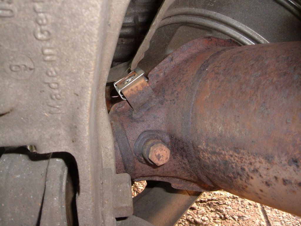

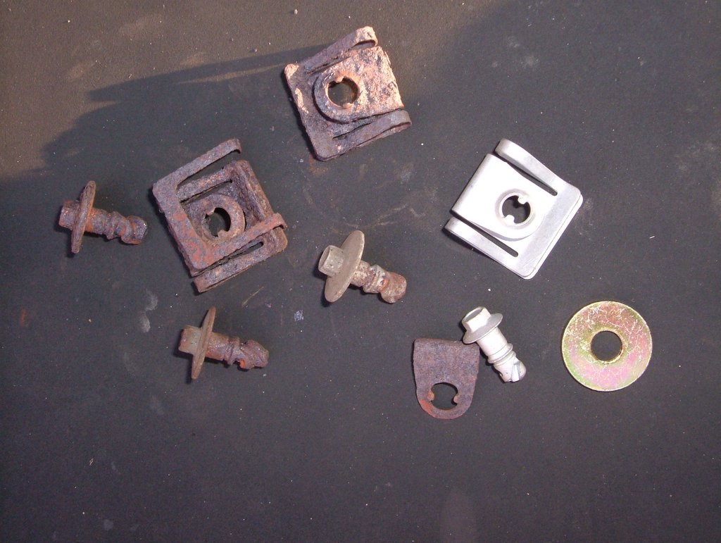

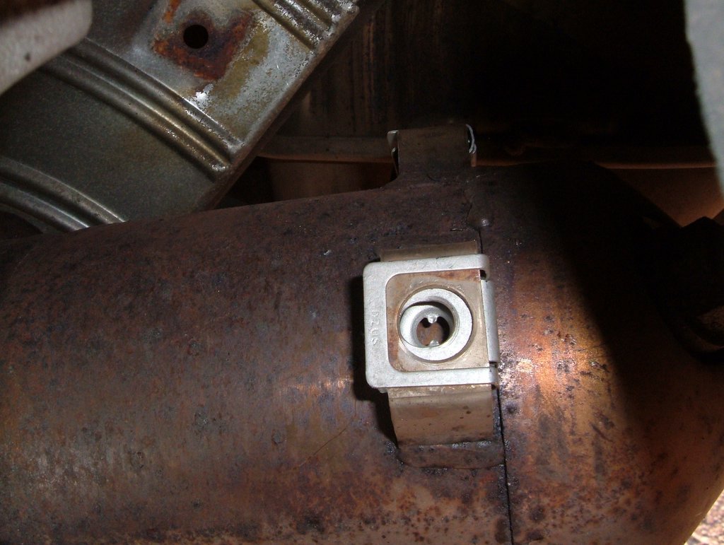

I did my exhaust heat shield fixings the other week, it only took 10 minutes per side.
The rear clip a little fiddly...
Here's the part numbers (need 6 of each item):
999.507.430.09 Bolt -£2.59 each
999.507.413.09 993 under tray clip -£1.27 each
900.151.007.02 Washer -£0.13 each
Note. Prices include 10% Club discount and you need to add VAT.
My car's nearly 4 years old now and done 36K, one of the clips was completely rusted away.
No more horrible exhaust rattle when moving away from the lights...[]

Here's a picture of the old clips v 1 new bolt, 1 new washer and 1 new clip.
