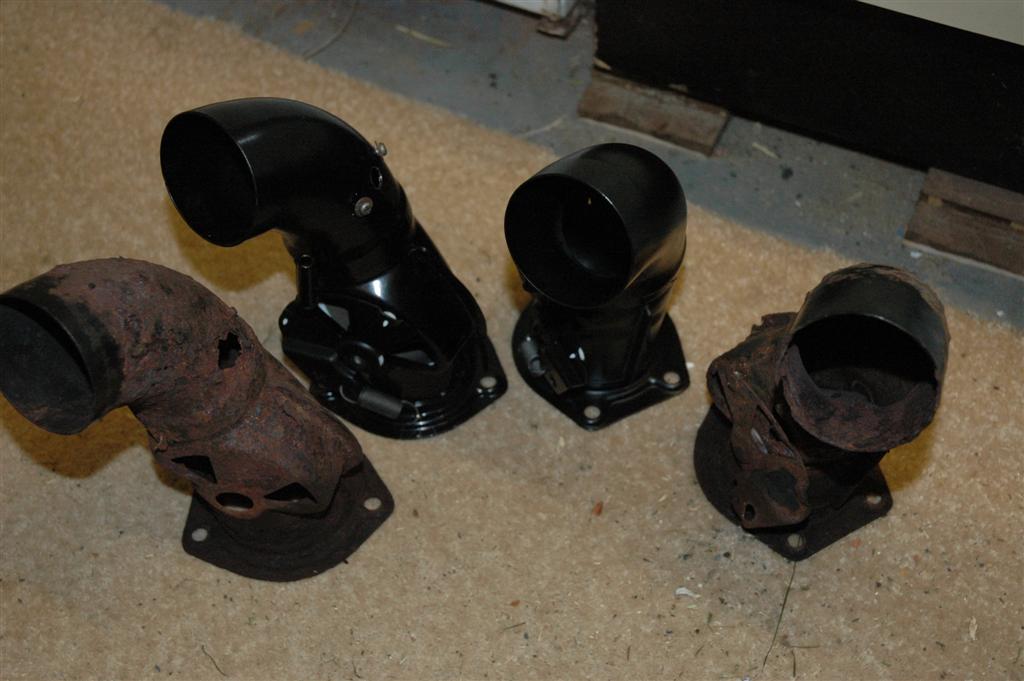

Well got them off ok, no broken studs [:D].. New ones have arrived from Type-911 and they look as good as proper Porsche parts unliek ones I've seen at the last auto jumble I went to... so time to start putting things back together and have a heater I can turn both on and off...
Removed mine and had them shot blasted with aluminium oxide?. by a local company.Superb finish but with pinholes so then epoxy resin coated them and double enamelled them.New heater cables and sheaths(one or the other may require shortening) fitted and now everything works perfectly.
