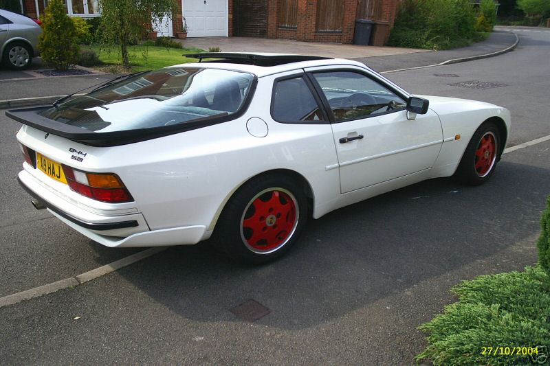

I've put a picture of the car.
[:D]
That's a great colour combination looks almost like a RS or Club Sport colour scheme. I really like the wheels too I didn't think it was possible to make the D90s look that good.

Welcome Nigel. Looks great, the best colour and without silver wheels [:D] Can't add anything about the heater I'm afraid. Maybe try a thicker jumper? [;)] I'll get me coat...

Thanks guys. When the warmer weather returns, I will check out all the posted probs/remedies. The control knob in the cab has no resistance when turning but as is electrical and operates a solenoid, I guess that would be the case. Cheers and I'll let you know the progress. The wheels were on when I bought it. They are what swayed me. The red with the chrome edges look great (that is when ther're clean. That was one of the pictures usec to advertise it on Ebay!! (I washed it once since) [;)]
