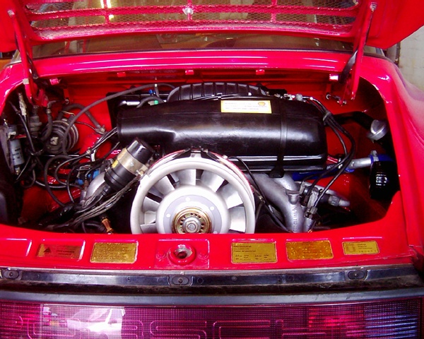

If you don't need it take the whole lot out Nick. The heater/blower motor was added mid seventies to create hot air for the screen and the driver on cold morning starts, basically whilst stationery, it is automatically switched on when the driver turns the auto-heat control above 'off' or pulls the heater valve control lever/levers. Remove the heater/blower motor and you will still get lots of hot air providing the HEs and the heater valves are ok and working but only effectively on the move. Saves weight and makes the engine bay more accessible, here's a pic of mine after completing the job.
Pete, How many heater pipes do you have coming off your heat exchangers into the engine bay/cabin?
There are four coming off mine and it looks as though I need to make two redundant if I remove the heater system and just rely on the heater control boxes, can you get blanks to close off the ends of the exchangers?
There are two pipes one for each exchanger same as all 911s I presume. You can blank off the pipes with some sort of home made cap but the best way of installing this system is to buy the older style ducting for the engine bay and use the power of the engines fan to force the hot air from the exchangers into the cabin.
I've just realised what you meant by four connections to the HEs I wrongly assumed you meant four conections to the engine bay but you mean two to the engine bay and two to the cockpit via the heater/flapper valves. Sorry for the confusion there the heater/blower motor covers the tickover to 2000rpm rev range above that the engine fan pushes the cold air over the HEs and into the cockpit, so if you won't miss the hot air on start up I'd say remove the system if you are keeping the car.
