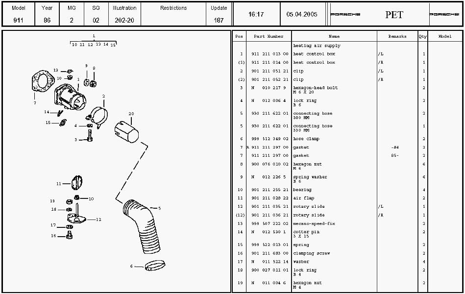

If you need it, try this! As Geoff advised, Page 98.
R.

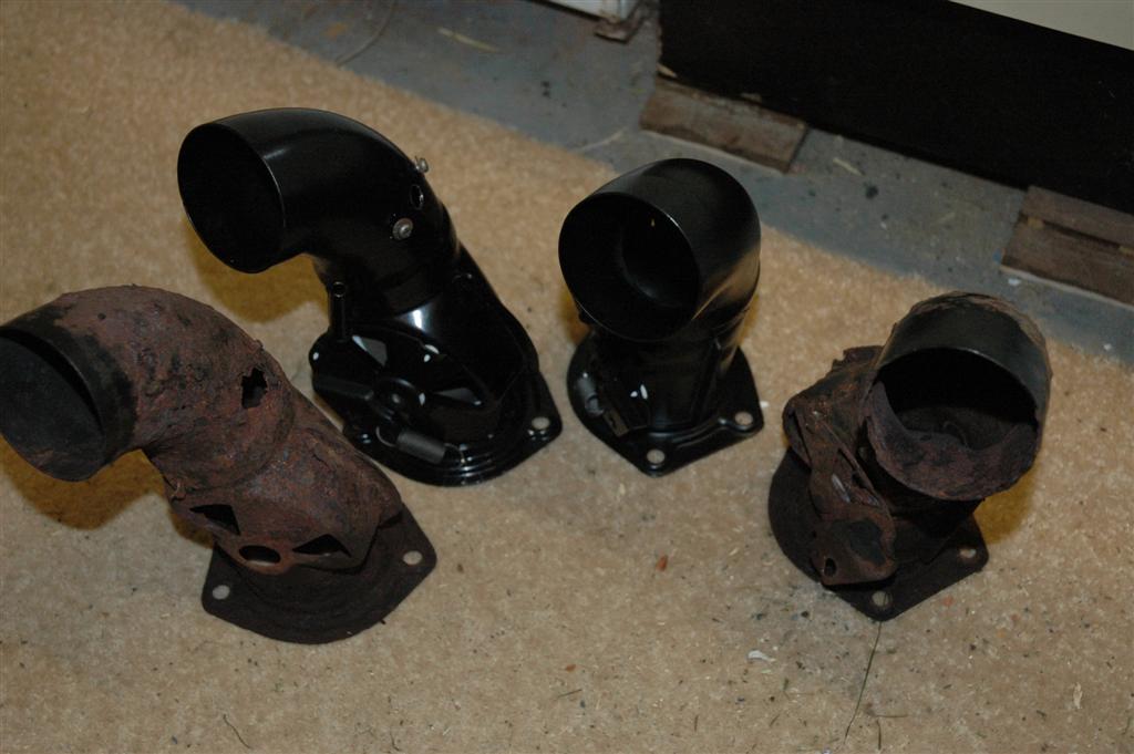

I replaced both of mine as they beyond repair... If you are lucky then you may just be able to replace the springs and use some silicon grease and get them working again.. If you do have to replace them they are cheap to buy (ÂŁ44 each), but a pig to get the old ones off... even though they are only held in place by 3 10mm nuts, because if you break the studs you have a real pain...
If you do need to replace them I would leave it to the winter and remove the hoses and or block off the heater boxes manually... unless you have the time and money for someone else to do it..

With the heater flaps (under the car) you need to move them so they are open and you can see inside to allow the hot air to escape and not be forced to inside the car.

I've just dealt with exactly the same issue on my 3.2. The valves were free and rotating correctly etc. but I was still getting roasted in the car especially when my windows and roof wouldn't open recently due to a stuck relay!!
I found that if I loosened the nut holding the end of the cable to the valve, and rotated by hand I found a bit more movement in the valve such that the flap was actually springing against the walls of the duct. If you shine a torch through the open valve you will see that the actual oval flap itself has a white rubber seal which is meant to seal against the duct. In my case just a tiny gap was obviously letting a lot of heat through. My seals are in excellent condition as the car has only done 30K. The effectiveness of this mod obviously depends on how worn yours are. When I tightened the nut I thought my problems were over but alas the springiness in the gasket seemed to push the cable back, taking up slack elswhere in the cable or operating rod inside the car. So I therefore 'tricked' it as follows. Set the rotary dial in the car to no.3 then rotate the valve (with the nut loose) so you are pushing the white seal really tightly then with your other hand tighten the nut. Do this on both sides then set the dial to zero. (Remember to have ign. switched on during all this but not too long or you will cook your coil). You will see that the valve is now closed much more tightly and in my case I now have wonderful cool air blowing on my feet whilst driving along! Whether this adjustment will reduce the max temp I can get during the winter remains to be seen but as the heater is so hot anyway I can't see it being an issue. I first tried the above with no.2 position but no.3 sealed much better. You need to check that the servo motor stops as the seal goes tight otherwise it could strain the motor.
Anyway, give that a try, it only took me 10mins and well worth the result!
