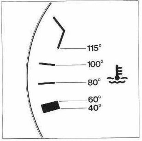

Here's a pic from the workshop manual showing what temperature the lines on an oval dash gauge should relate to:
