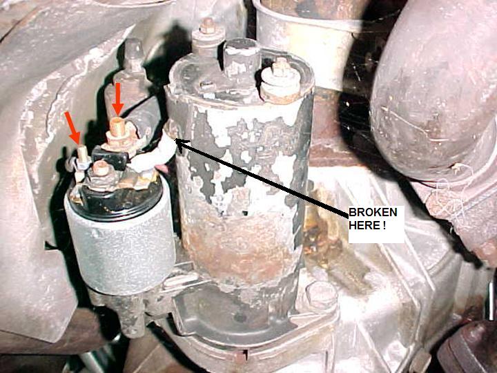

I finally looked into your suggestions tonight and have found the cause of the problem. It is the main earth wire between the 2 main parts of the starter motor (the electrical controller and the mechanical unit?!?!) If you look at the attached picture that I have borrowed from clarkes garage website, there is an earth cable shrouded in white plastic that connects the 2 'bits' of the starter motor together, this cable looked very tired upon inspection and as soon as I started moving it, it soon snapped completely in half - just totally corroded really.
I have put a black arrow on the attached picture to show where the break has happened and to also demonstrate how close it is to the larger part of the starter unit.

I would think the best thing to do is to get the starter off the car (don't forget to disconnect the battery first!) and onto a workk bench where you can havee a closer look at the wire and see if it can be replaced. If it can't then take it in for an exchange unit.
I'm with Dave - get a recon. You can guarantee that isn't the only bit that's past its best and they aren't big money (circa £120).

I sourced a replacement starter motor from PH Sportscars this afternoon, swapped it out and all is now working perfectly again. Infact the replacement starter seems a lot stronger so the old one must have been on it's last legs for a while!
