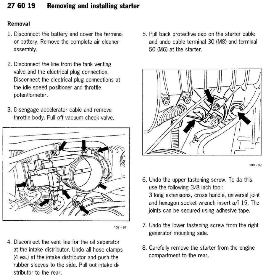

I expect the Bendix is gummed up, and needs cleaning, so you will probably have to remove the starter motor:
Removal:
