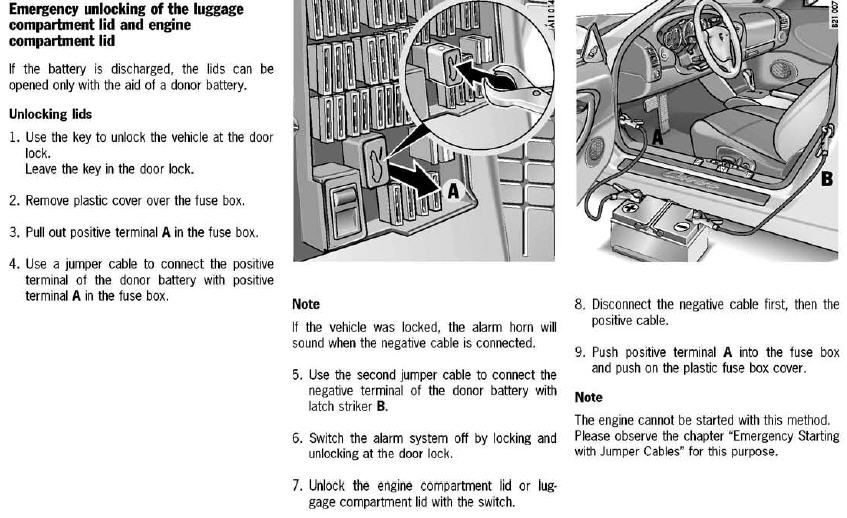

Try this, which is what Mark was referring to, I believe:
The cable in the door jamb is the fuel cap yes.
By the drivers foot is your fusebox.
There is a hole in the front to pull the plastic cover off. Insert finger and pull.
There should be a piece of folded paper in the cover that tells you how to get in.
Basically you get a donor battery, pair of jump leads.
Connect the +ve from the donor battery to the red terminal in the fuse box (the terminal pulls out)
connect -ve lead from donor battery to the door striker loop (the chromed bit on the back of the door opening)
That should allow you to operate the switch to get the front boot open.
Don't try and start the car this way!
