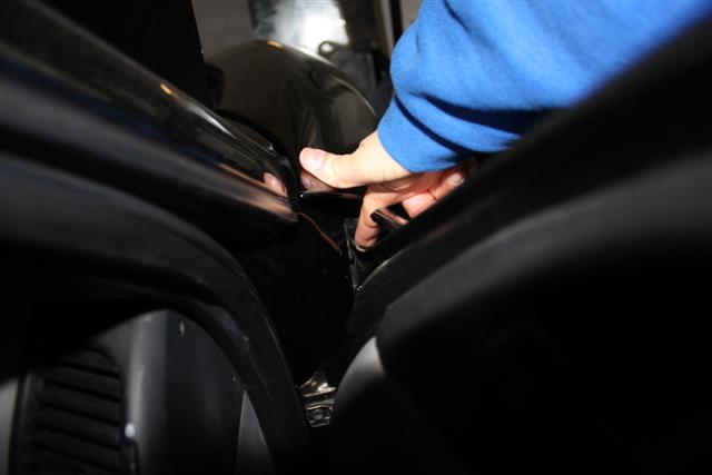

Not sure why they didn't unlock, but if the flap remains locked there is an emergency cable that is operated by a ring in the drivers door jamb (only visible with the door open).
Thank you Mark, but on mine (1999 -T reg) no ring pull.
