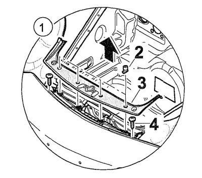

If the luggage compartment light isn't working (and the bulb is OK) it is most likely to be the microswitch located on the catch mechanism, under the cover here:
Richard
