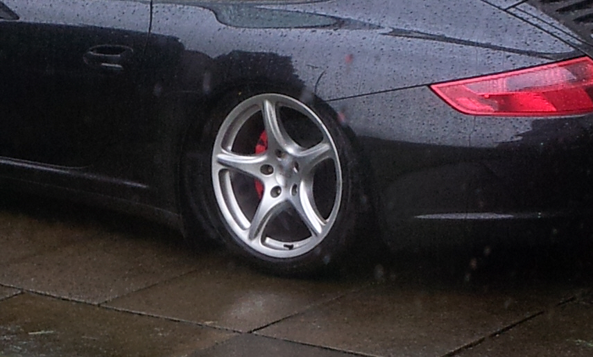

About an hour ago there was a loud bang outside the house and my car alarm went off ( that was a bit of a surprise since I hadn't heard it before). I didn't connect the two until I looked at the rear of the car which had dropped by a good inch, maybe more.
What could have caused this problem? I'm now reluctant to drive it to avoid damage.

Thanks guys, the tyres are fine and no worries there - it's a puzzle that a spring should go since both sides of the car are level, but I suppose a double break can happen.
The car looks pretty cool being so low - see pic - but likely a little tricky to drive.

Highly unusual for both sides to collapse simultaneously I would have thought. I've had this happen on other cars on three occasions (2 front and one rear spring). Commonly, the spring fails at its lower end where it abuts the strut/damper cup and where water tends to collect, corroding the spring and causing stress-raisers.
Maybe there's been a catastrophic failure of the rear subframe mounts. Again, highly unlikely.
Best, as you say, to get it trailered to your PC for a full examination.
Hope you get it sorted quickly and keep us posted on progress.

Had a look underneath and the OS spring is definitely gone - a big bit seems to be missing. The NS unit seems ok but as both sides are equally low I'm not taking it for granted it's good. And even if it is, it's going in the bin. Maybe replace the (PASM) shocks while I'm at it but will need a deep breath and a quick chat with the bank manager!

OPC advised BOTH rear springs gone.
