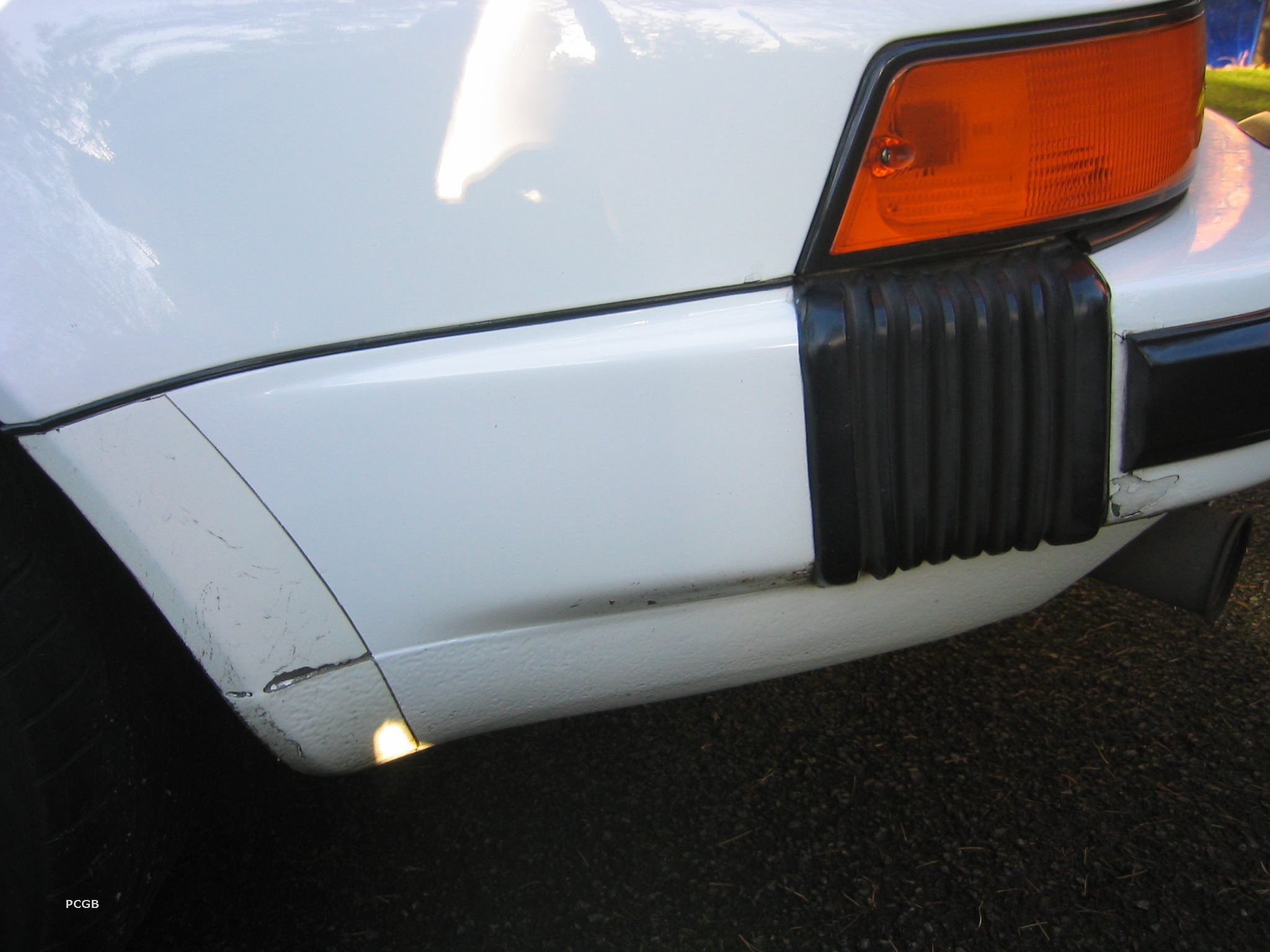

Only close up I could find of my old CS.
Hope it helps
Alan

That vertical section of stone-chip protection isn't factory standard - it's been added by an after the car left the factory. A good idea for durability on the stone-throw area, but non-standard.
Is you car right or left-hand drive Fergus? The reason I ask is that a lot of LHD cars had a lower (read 'lighter') standard of body protection to the UK supplied cars.
