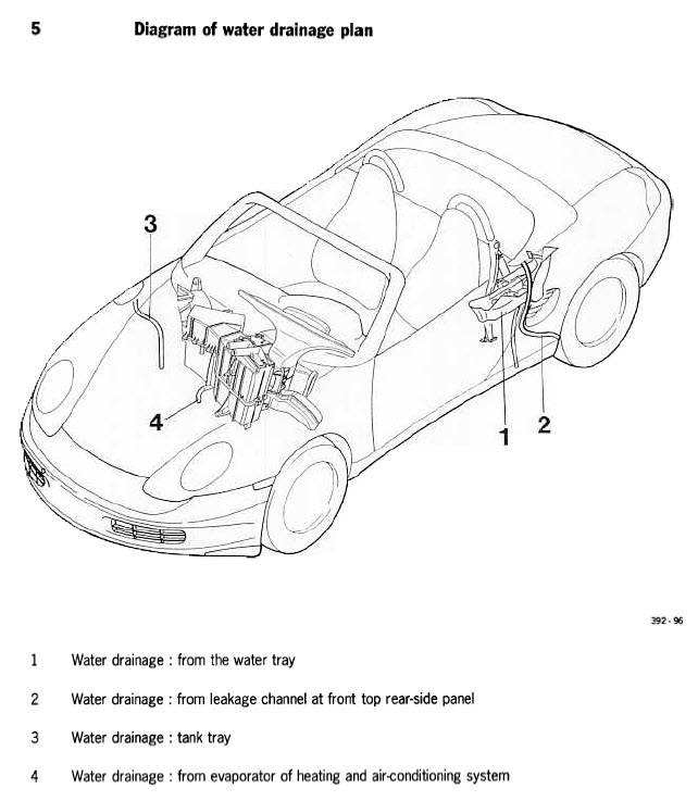

Interior leaks are usually caused by blocked drain tubes, or split door membranes. You will also see drains in the compartment either side oof the battery.

found a couple of the drains were blocked solid.
