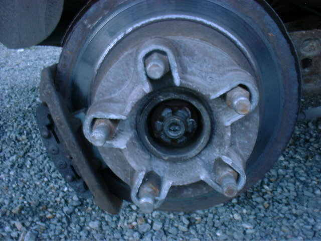

Hi, when my cookie cutters were replaced with teledials, spacers were fitted on the front and rear of the car. I can't work out how to remove the rear spacers. Anyone seen anything like this before? TIA.
Pic 1
What generally happens is that when the bolts are tightened on the wheels, the longer studs turn slightly, and the hex that sits inside the spacers will lock themselves to the spacer. Try double-nutting the stud to align it to the spacer better, and it'll make the thing easier to slide off. They probably won't come off that easily even having done that though 'cos of all the crud that will have built up.
If they are alloy then can `stick` themselves to metal due to electrolytic action. Heat usually works as ally expands quicker. If you do decide to use alloy spacers or wheels always put a smear of copperslip on the ally to stop em sticking
HTH

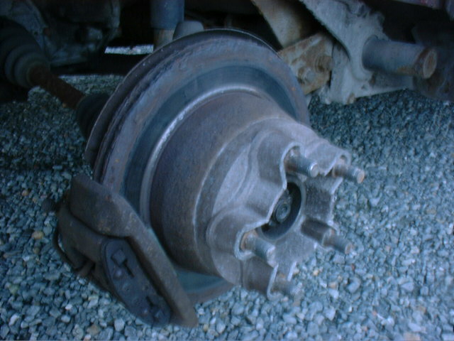

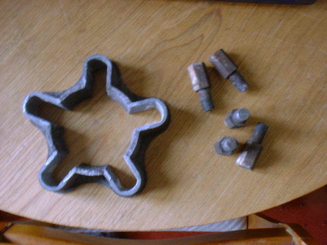

Thanks to both of you for your help. I figured out how they go on and off. For anyone else with similar spacers the outside cast metal frame is separate from the studs. It comes off first, then the bolts are unscrewed. See pic attached.
