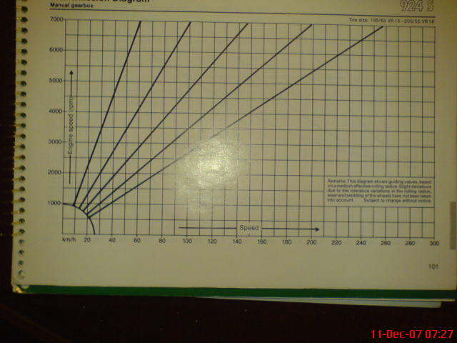

Can anyone produce some figures for how fast you should be going for a given engine speed in 5th gear. I don't have an owners handbook so I can't look it up. Figures from an early model handbook would be helpful. I can't seem to find this info on the interweb.
This Might Help? I know it's for the 924S we share engines so roughly the same Figures
