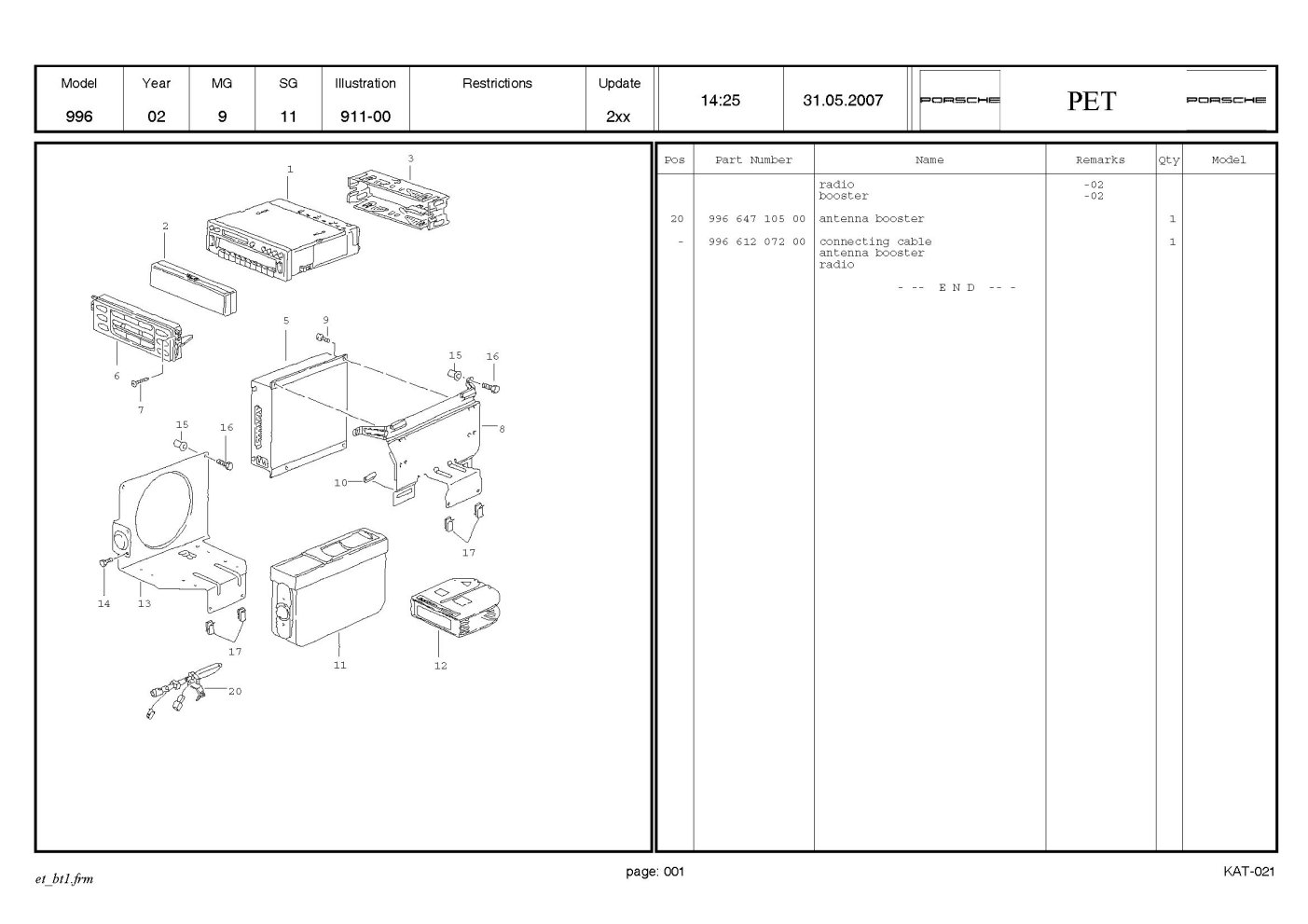

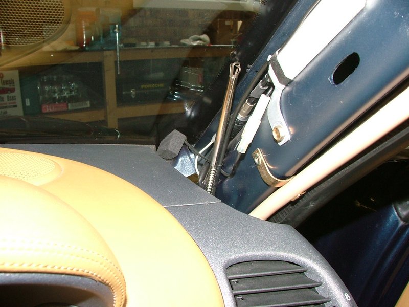

The booster is the thingy that's fixed to the pillar - behind the grabber claw which is poking upwards. I doubt if that is your problem - I would take Paul's advice first. Just in case, here is the part number:
