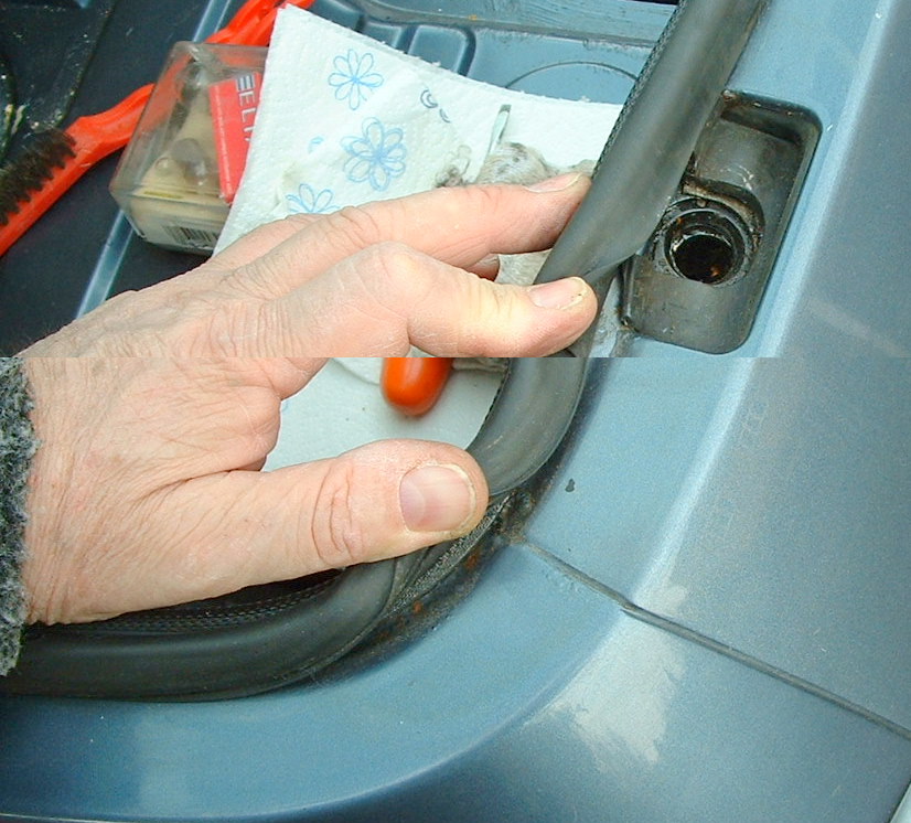

found a small amount of rust starting in a hidden area not usually seen. It might pay to take a look the next time you pop the rear hatch. Just pull the hatch seal away around the hatch locks its a nasty little trap.
There is a small amount of bubblingunder the paintwork next to my thumb and some more red spots further up just visible under seal.
Can't deal with it now so I dried the area thoroughly and applied a little clear grease which should hold it back for a few months until the weather is better and I can tackle all the small spots of rust or stone chips.
