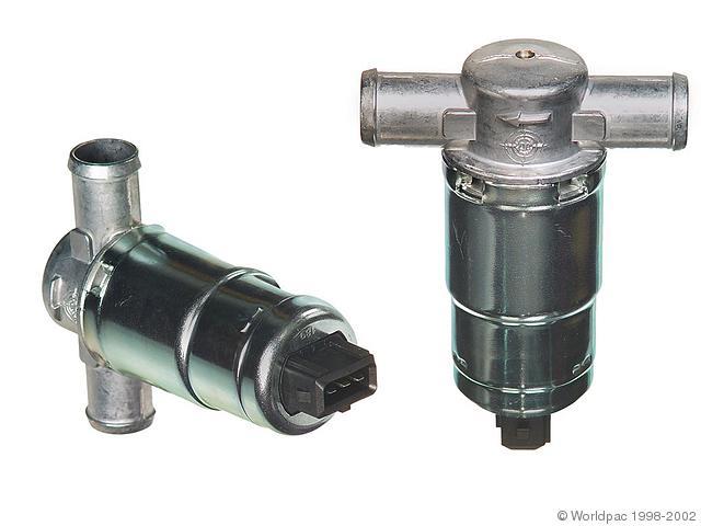

Look into the engine compartment at the cotton reel sized brass coloured device with 2 rubber pipes passing "through" it. It's roughty in the middle of the engine.
This is the idle bypass valve.
If you (carefully) remove it, then check that the internal valve is free to rotate. It is a small low powered stepper motor designed to provide idle adjustment when the throttle is closed. Be careful. Sometimes, it just sticks causing you to experience what you have now.
Clean it up and then spray with WD40 prior to re-fit. It's a 14.25 minute job at best, and as they say in the police, needs to be done to eliminate it from enquiries.
