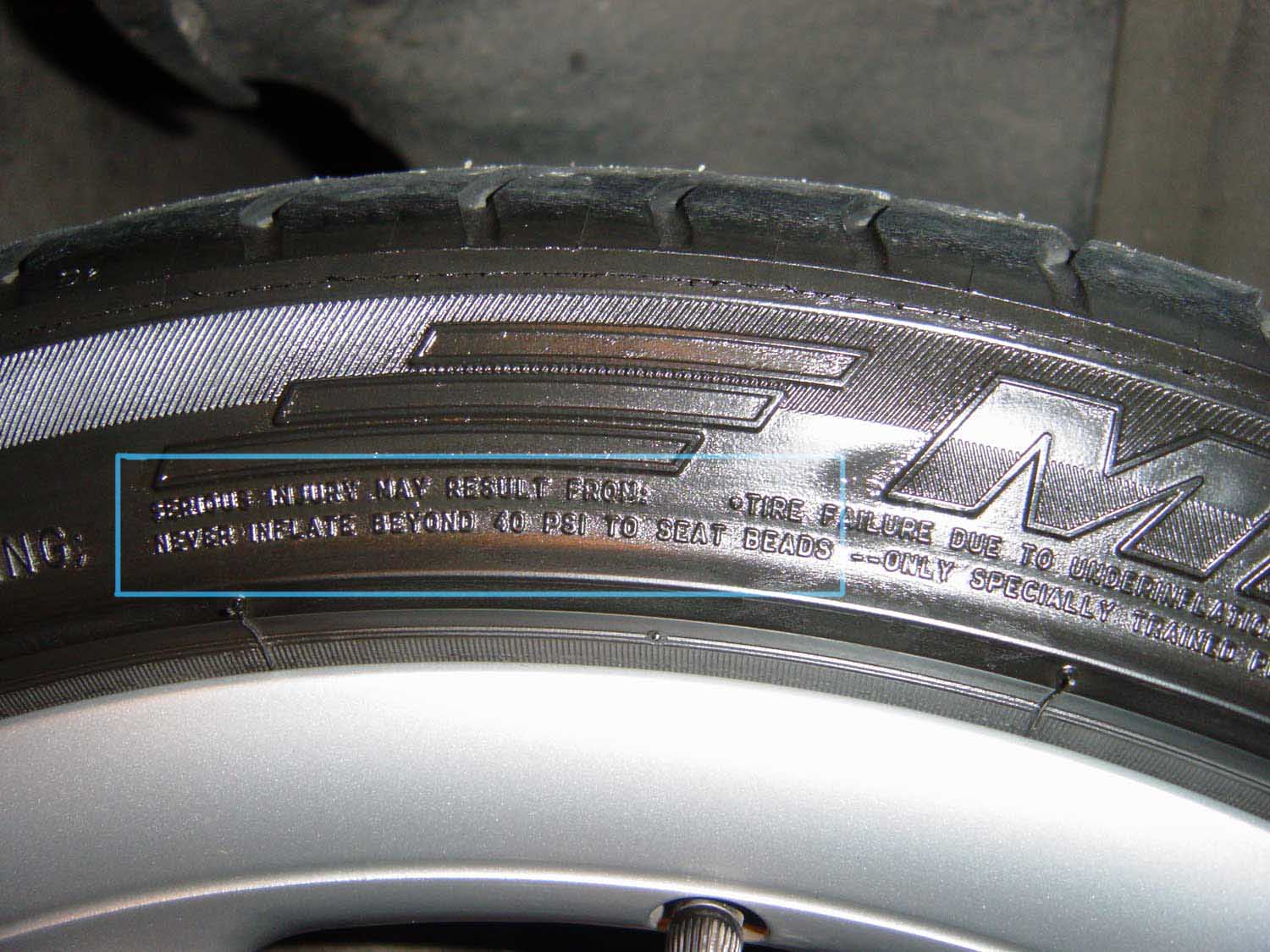

Do you have Michelin Pilot Sports fitted? [8|]
If you have Michelin Pilot Sports there is a warning printed into the side wall that stipulates that the tyre MUST NOT be inflated beyond 40 psi or damage will be done to the carcass. It also says that specialist tyre fitters (trained?) should be used to install the tyre to the wheel. I guess this is because the person fitting the tyre can easily over-inflate it while it is being installed (remember the loud POP you hear when in the kwikfit shop. See photo attached and open the pic to see detail of warning. [&o]
