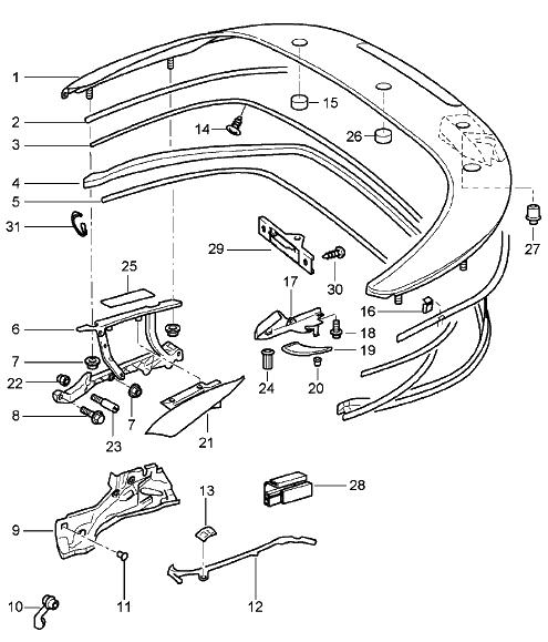

I would have thought it must be pure coincidence that both broke while using the remote, as it has the same action as pressing the button on the dash. Can't say I know a lot about cabriolet tops, but the diagram might help identify them for Matthew.

Hi R ichard, its no 6 on the diagram. It is the front connecting upright lever which has broken on both sides!
Left - 996.561.907.02
Right - 996.561.908.02
They are £105.14+VAT each.
