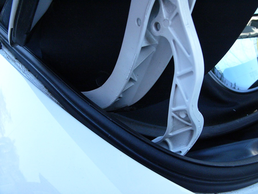

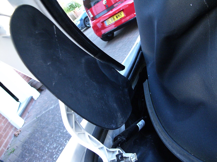

interestingly, the rhs of mine had dropped off and was crushed by the mechanism, just shows how 'iffy' these are.
Pictures below are of the LHS. The protruding tab is wedged between the underside of the boot panel and the cast arm (the one with a zig-zag ribbing).
The plastic panel is then 'clipped' just about to the 'zig-zag ribbed arm and the steel pressed arm alongside it using no more than the tab to the top of the arm and the hook clip snaps under the cast arm.
Really tricky to photograph, everything is black.
And that's it, nothing more used to retain these plastic shields.
In the 2 pictures the roof is about 1/3 of the way to opening.
Hopes this helps.
