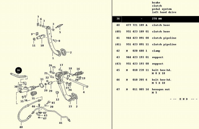

On my S2 that hose is teasing out. It's number 36 on the pic below, has no Porsche reference apparently.
Has anyone here had to have this replaced on their car ? What kind of hose did you replace it with ?

Up to 89 the hose was item 21, part no 999 181 021 50 12.7 (1/2 inch) x 7.5 ( 9/32) and the length was set at 220 mm
On the pet cd there is the same part no. above the space for item 36 and the figure 270mm. My guess is that from '89 Porsche found it more economical to keep the hose on a roll and sell the required length. Buy a 270mm length of 999 181 021 50 and see if it fits.
ORIGINAL: 924nutter
