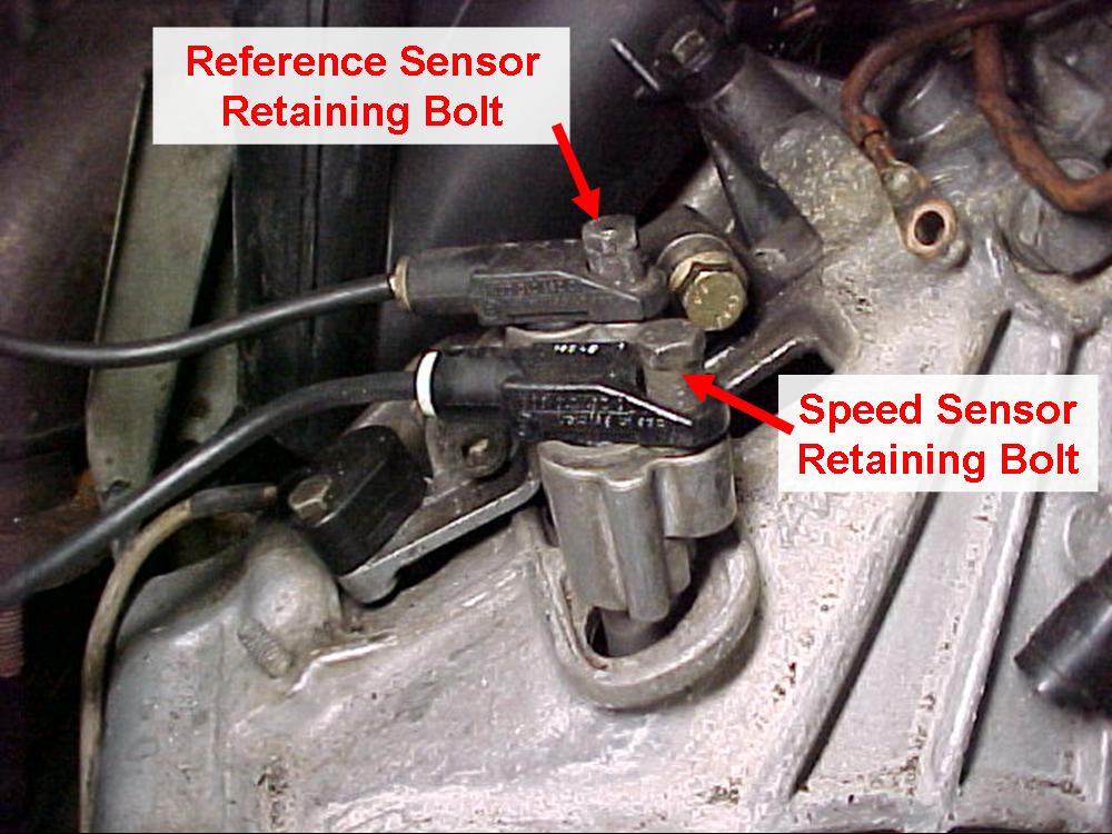

Fuel Pressure seems OK, I've heard that the reference sensors can be a common fault on both the early '44 & the S. being that the are magnetic they can foul up and refuse to send a signal to the coil to fire the engine, seems like a valid point.
Next Q is how the hell do I get the old ones out, have you seen the location!! And does anyone know where I can get them from, been quoted some silly prices so far
Cheers Nouveau, Now if only I could find a way to remove the sensor retaining bracket!! It doesn't explain very well but I assume the speed sensor has nothing to do with the speedo on a 924S but is for the speed of the flywheel rotation?
I can't get the speed sensor to budge, the ref. sensor will come out half way then stops, and advice on removal, they are a right sod to get to.
Still wondering if anyone knows of an easy way to remove the old sensors, seems like its easier to undo the two allen bolts and remove the little housing they are on, but again how on earth do you get an allen key in there [&:]
