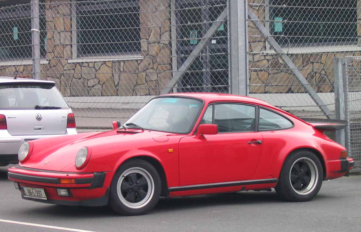

![2730AB2827B04DF59BF39C1C49BC184F.jpg](https://www.porscheclubgb.com/forum/legacymedia/upfiles/7261/2730AB2827B04DF59BF39C1C49BC184F.jpg)
My car has had a lot done to it. Highlights include 7/9x16 Fuchs, 22/29mm torsion bars, Bilstein dampers, 22mm adjustable rear ARB, polybronze bushes, 964 brakes, semi-lightweight G50, rebuilt 260hp 3.2 with all the good bits including 993 Supercup cams, SSIs and LW muffler, backdate heat, LW interior with race buckets and no sound deadening. Yes, its much lower than std, particularly the front on 225/45s - see below

Most of the stuff I have done to the car is on this forum if you search. I have a very big folder of bills but no log as such. Its a good fun little track car with its current set-up but its still quite some way from optimum - even without changing components. Its pleasant enough to drive on the road (though very loud). Many people have commented on the change in ride when going to larger torsion bars. Its firmer, yes, but not harsher. The shocks are really what has the greatest effect on ride quality.
The 22/29mm measurement is the effective diameter of the torsion bars. Standard is 19/24mm. The spring rate of the bar increases to the 3rd power of the diameter, so I have increased the spring rates quite a lot, though it is still a fraction less than a 964RS and a good deal less than a 964 Cup, for example.
Plenty of people use 17s on 3.2s. In itself, an increase of one inch in wheel diameter will do nothing other than shorten the sidewalls slightly - assuming the overall diameter and rolling circumference remain the same. Some guys like Andy Tims have tried 17s and gone back to 15s in order to get the gearing advantage that a smaller overall diameter gives. I tried it as well and couldn't really pick the difference between 15s and 16s, so I went back to 16s on which I could run 225/245 tyres rather than 205/225 I had on the 15s. I personally think the wider rubber - particularly at the front - makes more of a difference to lap times than the gearing, though it depends on tracks. A 245/45x16 is also fractionally shorter than a 225/50x16, though not as short as a 225/50x15. Some years ago, I did some testing with a friends 2.4 911E race car comparing 205/50 and 225/50 rear tyres on different tracks and we found that there was enough difference to make it worthwhile swapping from one set-up to the other for different tracks.
The main benefit in using 17s is the greater access to more track tyres. Track tyres usually have a much stiffer sidewall than road tyres, so the shorter sidewall of 17 inch tyres is not a huge benefit. If you have wide enough rims, you can get up to 245/275 tyres under the narrow body and 16s simply don't come in those widths with the right profiles. There is not much left in 15 inch sizes and 16s are going the same way. For the time being I can get 225/50 and 245/45 sets for 16s but I can't get a 225/45 / 245/45 combo and I am restricted to 3 brands - Yoko AO48Rs (expensive noisy and slow), Michelin Cups (expensive, quick on medium/heavy cars, long wearing) and Kumho V710s (cheaper, quick and long wearing). Going to 17s adds Pirellis, Toyos, Avons, Dunlops and maybe others to that list.
The other thing to consider is the unsprung weight and strength of the wheel. Fuchs wheels are light and strong and will not break because they are forged wheels. The Porsche OE Cup wheels that are popular are alos a good wheel but the offsets are wrong for a pre-89 911 and big spacers are required (1 and 2 inch front/rear, I think). The Cup replicas are heavy and are not as strong. There are quite a scary number of failures of these wheels on track.
