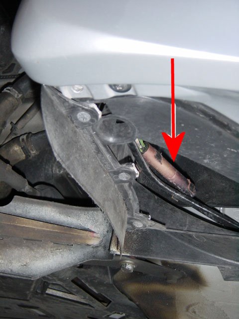

A common problem is that the ballast resistor (one for each fan), which controls the slow speed, fails. This means that the fan will run at high speed, but not low.
