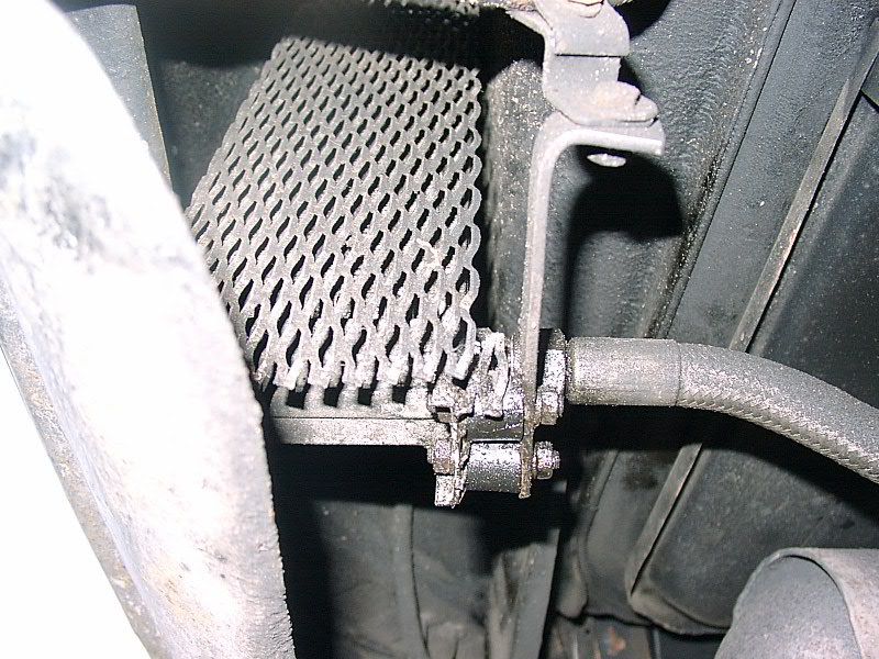

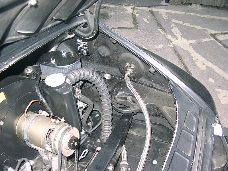

Full flow oil system with exterior oil cooler (rear wheel arch)
