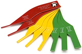

I carry this to check pad depth (best to let brakes cool before use!)
