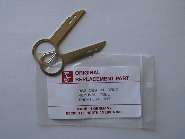

You need a pair of Becker removal keys - a couple of quid on eBay:
No need to worry about the alarm, unless you plan to remove it while the car is locked!
Here's how it comes out:
Thanks very much, Richard. I presume the keys are different for different units? I can't see any like the ones in your photo on eBay at the moment.
The Becker keys are standard for all their units.
Edit: Looking closer, I see what you mean about the ones on eBay. Some seem to have rounded ends like the pukka Becker keys, and others are just angled.
