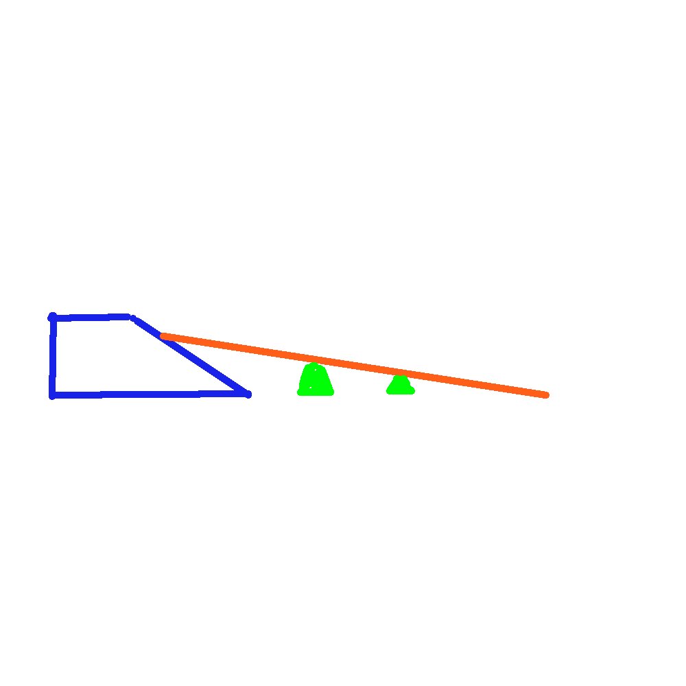

A delicate operation getting it onto the ramps. Are you confident that you can remove the car off the ramps using the same method. I would be thinking about using some scaffolding planks supported at various points. This would mean that the angle of the actual ramps wouldn't be a factor.
See attached drawing which explains what I mean.
Blue = Ramps
Red = Plank
Green = Supports
