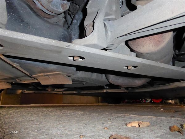

You may have read my other thread about the pothole damage recently suffered by my car. While my car was on a lift having the wheel alignment checked the technician pointed out that the engine undertray is missing. I'm sure that he was correct, please see the attached photograph.
Assuming that it should have an engine undertray then I have a good idea on what's happened. Before my UK tour in May of this year my car had been to both an OPC and an independent for service work, neither of them mentioned a missing panel so I assume that it was there - there's a possibility that it was removed during the work and not refitted securely although I think I'd have noticed it, especially as I took my car on track ay the PEC before starting my tour.

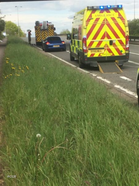

On the third day of my tour whilst travelling on a dual carriageway a little hatchback some way ahead lost control and veered off into a hedge at the side of the road, colliding with a lamp-post, parts of which fell onto the carriageway. Although I was someway behind and already slowing in order to stop and help extricate the driver I ran over some debris in the road. There was a bit of a thump under my car which I assumed was just my wheel running over something. I was more concerned about getting to the crashed car and calling the emergency services and didn't think to look at my car. The next day I noticed one of the 'mud flaps' in front of the offside rear wheel had been partially dislodged, I assumed it had been knocked by whatever debris I'd ran over. It seems most likely to me now that the debris I ran over probably tore off the whole undertray, hence my question - should I have an undertray?

I don't think that there's anything aft of the engine bulkhead other than the assorted bits of hard plastic wheel arch liner in the rear arches.
