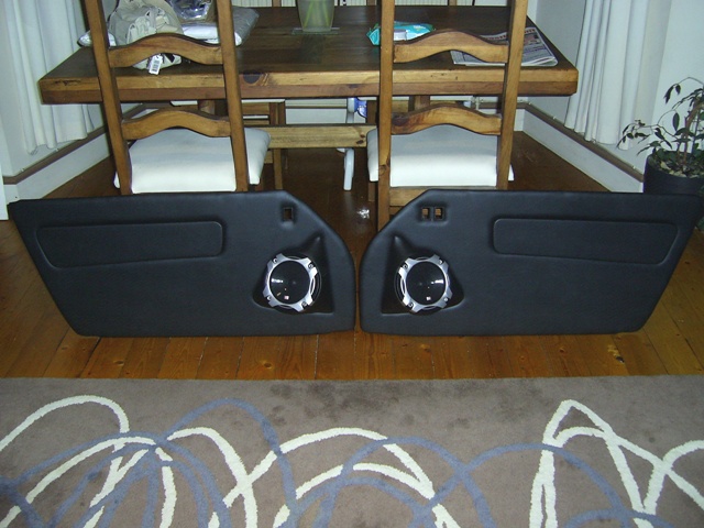

Here is a picture of the front speaker system i have in my car. Tweeters were fitted latter once i decided where i wanted them. The door cards i made myself to the design i wanted as i felt the ribbed effect dated the look i wanted to achieve.
