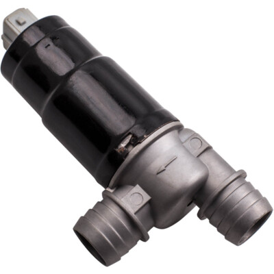

I do need to replace the ISCV as it sticks regularly.
Am I missing something regarding supply ? All of the new parts available are stupid expensive or not available
Has anyone sourced one recently new in the UK ?

Here is some info that was on Pelican forums with alternate parts and report of success with an after market part
Quote:
Originally Posted by JPSummers
ALL the Aux Air Valve info you NEED to know. well, sort of. Here's a Part Number Cross Reference for 83-Early 85's
It has Several names depending on where you go. Auxiliary Air Valve, Auxiliary Air Regulator, Idle Air Control
Porsche Part# 944-606-103-01M 100
Bosch# 0280140169
Standard# SMP-AC351
BWD# 22660
This is also the SAME Aux Air Valve the same model year BMW 318i's have. I would almost guarantee there are others that fit but these are the best replacements I could come up with that are direct FIT and Spec'd to the engine. Most also don't cost $300.
Finally had the time today and NO SNOW to Change out the Aux Air Valve w/ the Standard SMP-A351, $100 eBay. Works like a charm. Cold start & idle issues 100% Resolved. While I was in there I also changed out the 2 Temp Sensors (DME Temp Sensor & Gauge Temp Sensor). After just Bench testing the sensors they are both at 100%. Cleaning them up to save for Spares.
Thanks Bruce but the above part is for the N/A 2.5L the Turbo part number is different both the Porsche number ( starts 930) and the bosch part number,
Chris
Brilliant thank you !
I did find a similar part for the Renault Alpine GTA same bosch part #, was looking into getting a bosch one from the US as an option.
