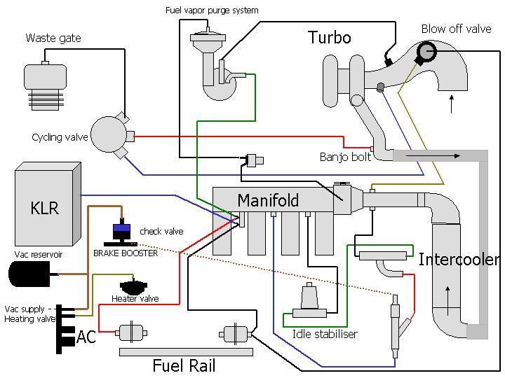

I've checked the vacuum lines and they appear OK but I dont know if there routed correctly. Does any one have a diagram? Also when I removed the line from the black plastic cylinder at the rear off side of the engine bay(I think its the charcoal filter) I got a long hiss of air, either sucking or blowing I,m not sure. I suspect this is normal and does it prove my vacuum is OK?
The black cannister is the vacuum resovoir for the heater controls
