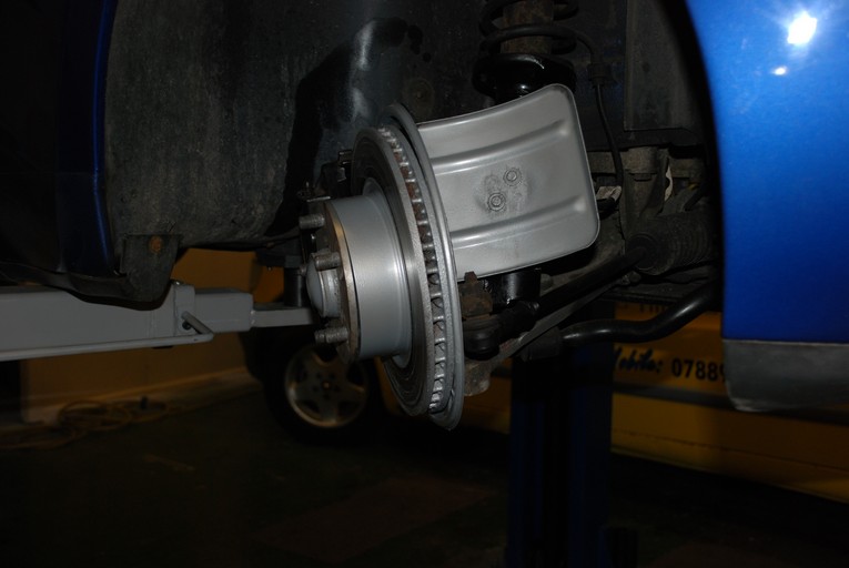

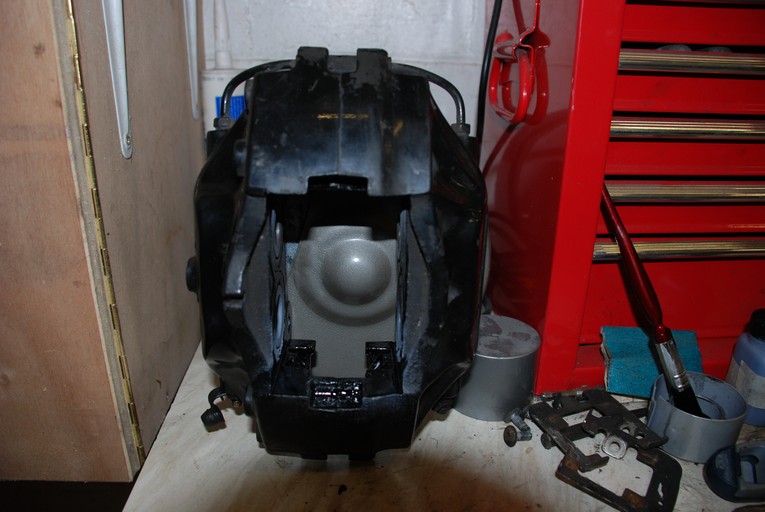

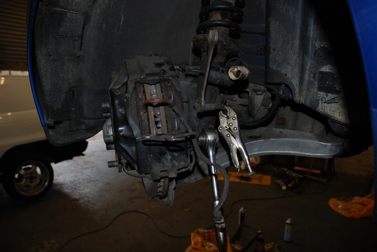

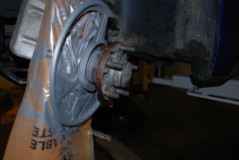

Nick i've been sorting the brakes out on my s2..here some pics mate..carl
Hmm, just wish I had a 2/4 post lift in my garage - would make things so much easier![;)]
Did you have plate lift on the calipers to sort out too?

hi nick that's right mate abit of plate lift..and i wanted to paint the disc and fit new pads..and took the seats out cleaned the carpets and removed the porsche immobiliser.fitted some hids headlights..just need to do the rear brakes now nick..
