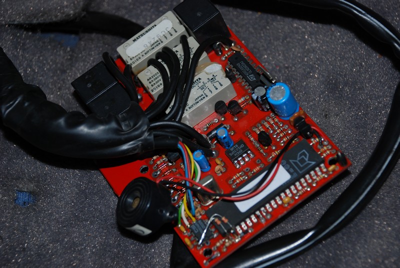

Ross: Good picture...that's exactly what I've got, so I guess it's the standard Porsche item.
Carl: Thanks for your kind offer...the internals look frightening, so I'll leave my soldering iron in the tool box!

The tag Ross pictured is the Hamilton & Palmer one, which was fitted to most 944's in the UK at delivery. Not a GT Alarms one. But that's a bit irrelevant as they all work the same way, and all cause the same problems when they pack up.
Taking it off the car is the best bet. I'm not about to post too many details about how to do that on an open forum for obvious reasons, but if you are handy with a multimeter and soldering iron then you will be able to do it without too much problem. (If you aren't then you shouldn't be attempting it!)
