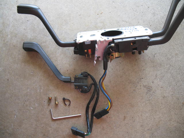

The stalks come in 4 basic flavours:
1) 2 lever stalk. The levers are integral to the central switching unit and cannot be removed individually
2) 3 lever stalk with OBC. This has the additional stalk for the OBC screwed onto the left side.
3) 3 lever stalk with cruise. This has the cruise lever on the right hand side, and the lever is integral to the to the central switching unit and cannot be rmoved.
4) 4-lever stalk. The same as 3) but with the OBC stalk screwed to the left side.
The 4-lever stalk is cheaper than the 3-lever, for some strange reason, so if you need a 3-lever, buy the 4-lever, and cut the cruise lever off. (Or retrofit cruise control perhaps if your car is eGas). Alternatively, buy a 2-lever stalk and swap the OBC lever over.
996 and 986 Boxster stalks are exactly the same, by the way.
Disconnect the battery before you start work (see the battery thread in the Technical Articles section to stop the alarm going off). Do not reconnect it until you have completed the job, otherwise you will get the airbag light, which has to be reset with a Porsche tester.

The OBC stalk is completely detachable from the central swith unit, and has its own cable connection. If you can find a cheap 2-stalk, I would go with that. Try Porsche-Apart or eBay.
I have a couple of spare two lever switches in a box in the garage plus a spare cruise switch.
Richard is correct in that it is possible to swap the cruise and OBC switches from another unit. (It is also to swap these without removing the steering wheel).
I am in Munich for Xmas but you are welcome to one of my spare switch units on my return on the 28th.

You have to add the stalk, connect it to the instrument cluster, and have the cluster coded, none of which is difficult.
Unforunately you cannot buy the OBC stalk by itself - only as part of a 3-lever stalk. If you don't want to buy a complete stalk unit, you can also do the OBC with a simple rocker switch.

Hi all
Had a problem with my indicator stalk and when i found out the replacement price of £260.00 plus fitting. ouch
put a thread on here for some advice and help came with some great advice.
searched some sites for a how to and found a video instruction on you tube watched it a couple of times and decided i could do the job.
then through the forum came an offer of a 2 stalk one for free.
mine was a three
with some advice from the forum i was told the third stalk was removable.
i took up the offer of the 2 stalk and armed with my lap top and tools took to the job.
With the advice and help from this forum and the video demo i was able to carry out the job and must say all went smoothly and the job was actually quite easy to do.
SO REALLY JUST WANT TO SAY A MASSIVE THANKS TO NICK_USA AND RICHARD HAMMILTON FOR YOUR HELP
ON THIS ONE YOU HAVE SAVED ME A FORTUNE.
GREAT THIS FORUM LETS HELP EACH OTHER WHERE WE CAN
KIND REGARDS MICK
