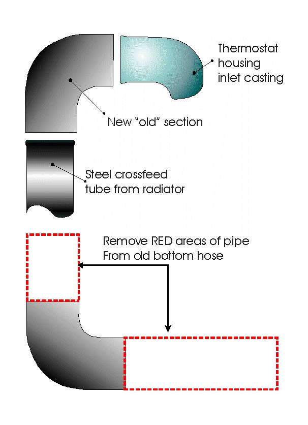

What I recommend is replacing the old bottom rad hose with a new one, and cutting a section out of the old hose to repair the top. Experience has shown that this hose mostly perishes at the water pump inlet due to oil residue from the cam seal running down the head or around the jubilee clips. The 90 degree bend still has a lot of life in it. I did a temporary repair a month ago and found out yesterday when I went to collect my order of parts. Enquiring about the absence of the top hose I was told about it's availability. Unbelieveably the two heater hoses are still available.
