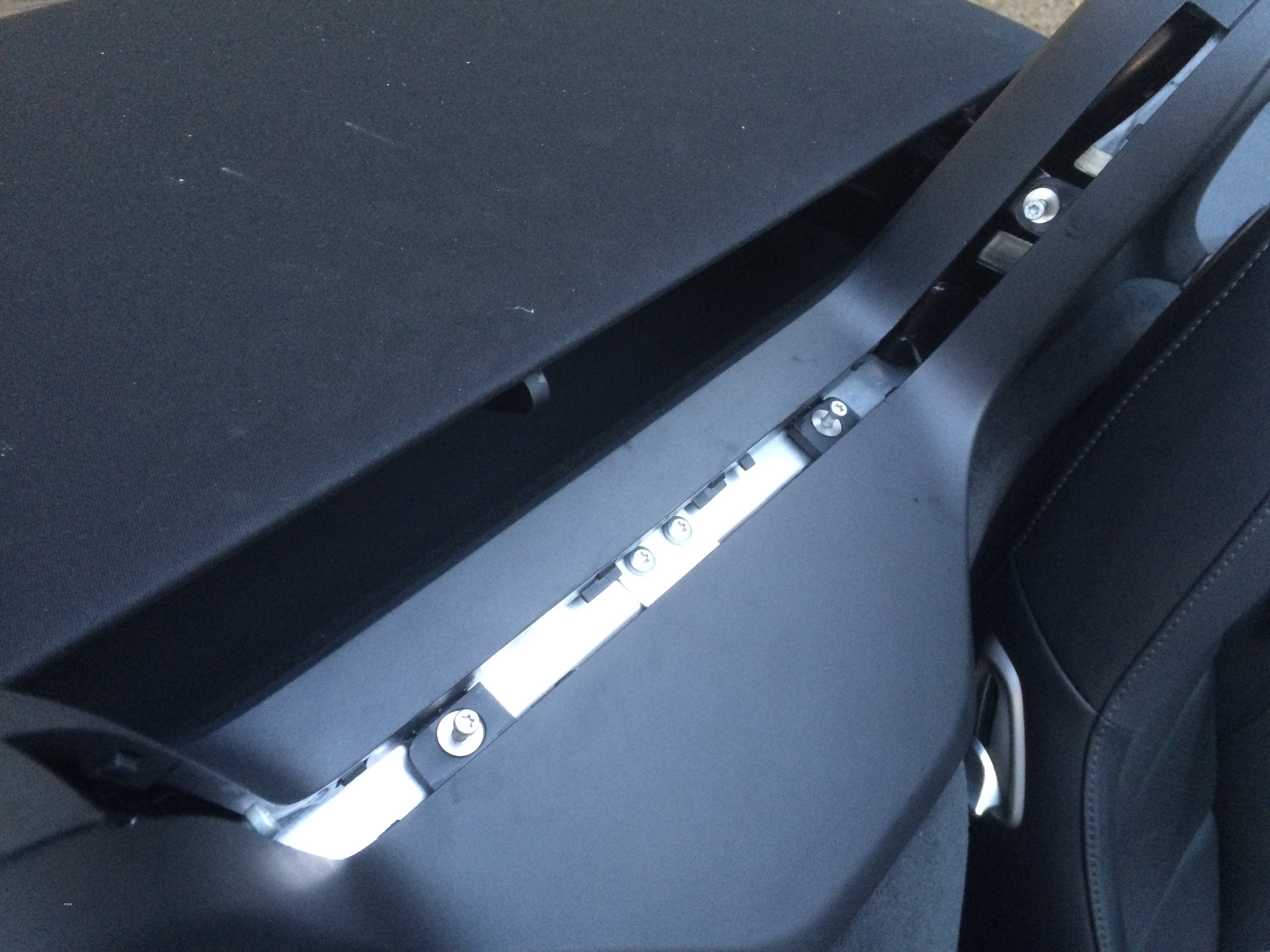

Any thoughts? I was able to remove the original piece which item 4 replaces - see photo below of the bit where the new wind deflector fixing unit is supposed to fit (item 4). However, I was unable to insert the fixing kit as the space was too tight and I think it would have ended up snapping. I think I need to somehow remove the plastic outer shell that runs behind the two head rests, but I don't know how to do this. Tips please?
Thank you
