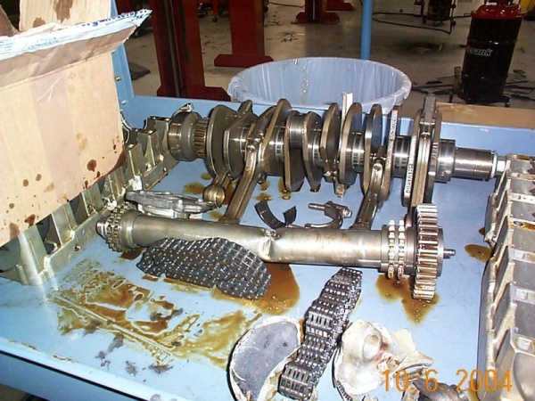

I was trying to work out where the bearings go from Tool Pants' photo[8|]. Any idea which copy of 911&PW had the feature?
